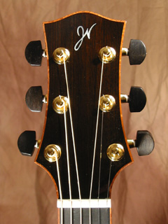

Incidentally Jim... I really like that logo you are using in your avatar. I presume that is your headstock logo?

Brock thanks for your compliments on the logo. it is my head stock logo. Here's a pic.

[QUOTE=Jim_W] Alans absolutly right about the thickness needing to be identical and this why I always contend that flexing a top is no way to judge initial stiffness. A little change in thickness goes a long way! Length and width are linear however and not as critical, they do matter however.
Too many factors to speculate, just pick the one that sound the most musical to you. I've found that the bridge weight can have an important impact on the overall sound, as I'm sure you know. Any way just keep track of all stuff and some day we'll know what all the data means (maybe).
Brock thanks for your compliments on the logo. it is my head stock logo. Here's a pic.[/QUOTE]
Not to hyjack the thread but man-o-man is that one elegant headstock design and logo! Even though it is a bit "Ryan-esque" I still think it works well.

Thanks very much Tim.
